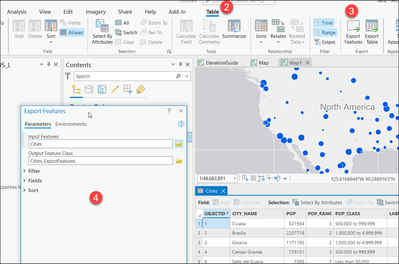

ArcGIS Pro 2.4.2: Exporting Data tool from map service is not available,
For example, in QGIS, there is a simple way to export data from map service. Why such tool is not available neither in ArcMap not in ArcGIS Pro
12 Comments
KoryKramer
That image shows you're exporting from a feature service.

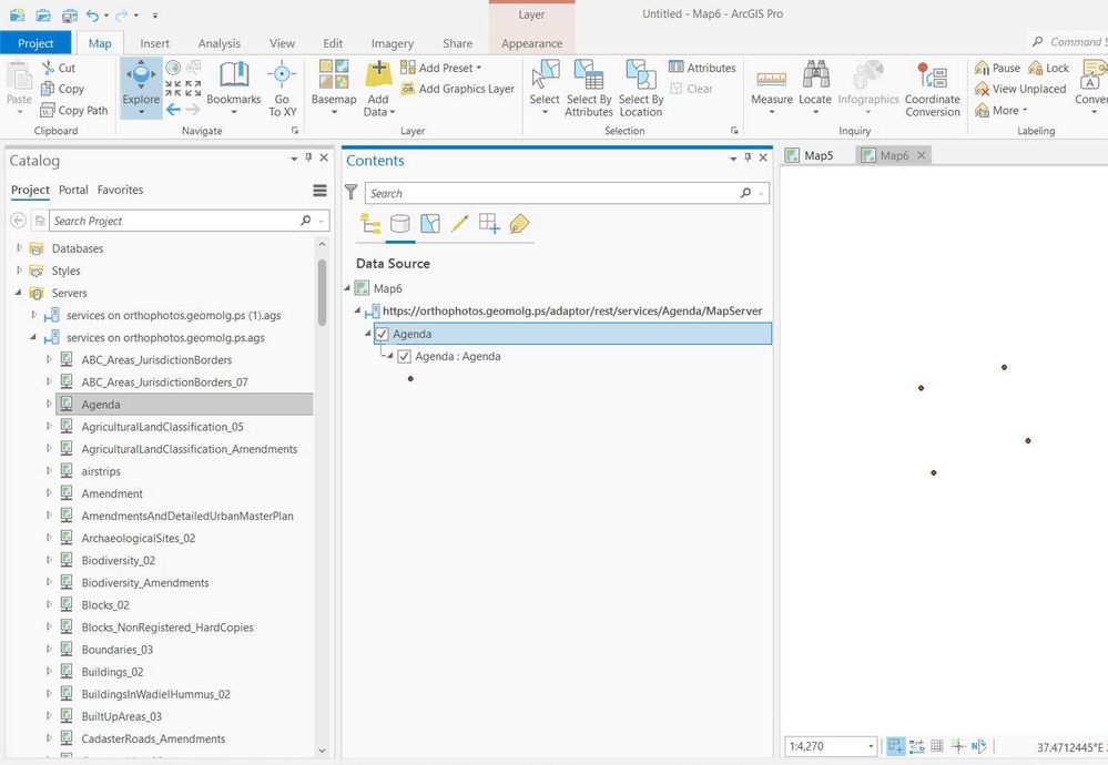

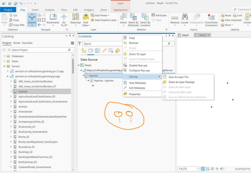

JamalNUMAN
At the end of the day, in QGIS, one can export the map service as shp file. This appears not to be available in ArcPro
The “export map” has no option to export the service as shp file
What do you think?

In a rare act, I'm going to go with "Already Offered" on this one...
If you add the "numbered" layer from a map service, you can export it. Example, add data from path, add URL, use https://domain.com/veg/rest/services/GRSM_EXOTICS/MapServer/0, right click on layer in TOC, Export....
In addition, this also allows you to change the symbology.
Note the difference here: I'm not adding the SERVICE, I'm adding a LAYER from the service, even if the service only  has one layer.
Probably not entire efficient, but making it work the other way I suspect would involve significant changes to the REST API.

Correct. I could export data from the service layer in Pro (is this possible in ArcMap?). However, this is not generic. ArcPro fails to do so in many cases.
If you try the link below, you will be finding out that the ArcPro fails to export the marked service layer. What could be the issue?
https://arcserverg.paltel.ps/adaptor/rest/services
