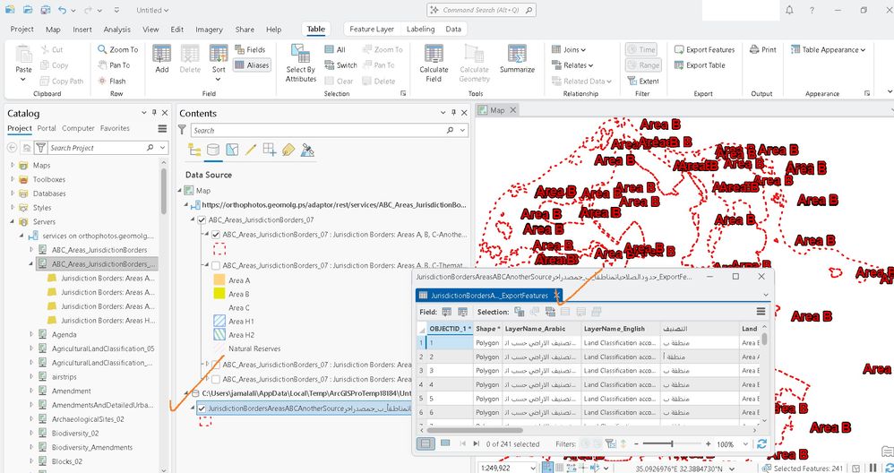

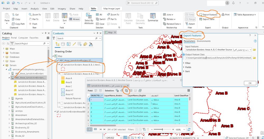

ArcGIS Pro 2.4.2: Exporting Data tool from map service is not available,
For example, in QGIS, there is a simple way to export data from map service. Why such tool is not available neither in ArcMap not in ArcGIS Pro
12 Comments
JamalNUMAN
I tried it in 3.4.2 and it works fine
Why the Export is not on the right click? this is much more intuitive
