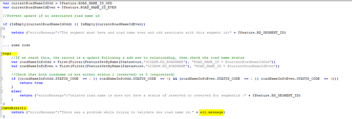

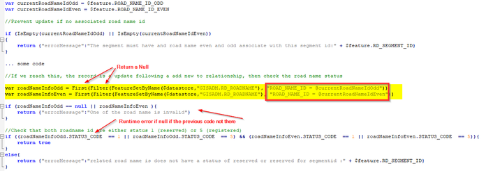

However, a try catch would be helpful to capture runtime error and send a more descriptive message. Here an Example. In that code sample we validate (Constraint Rule) the the new value the user entered really exist in an other table (we validate the relationship). I edit the code to simplify the example.
In this example, If the Filter returns nothing then First return Null. To prevent a runtime error I need to check for null before getting the .STATUS_CODE attribute. Depending on code there could be many of those kind of check. Also, it might be something wrong with a library, or something we did not think of. I would rewrite like this
In other scenario I written function in my arcade script (ex: recursive, reuse code, etc) I might also be interesting to be able to throw Exception instead of outputting and array like having the first element a Boolean for success or Fail, and the second for the data.
As for sending My own Exception outside I recently see that now the full attribute rule error message we see in pro is not sent to the .Net SDK. That is good. If you could go a step further and being able to the the detail in an object (Rule Name, Error Code, Error Description, etc ) but I guess I can deserialize the Json my self. I also notice the tools like FME does not report error correctly when the is an attribute rule constraint. The is just an generic error message the the message part is just {}.
