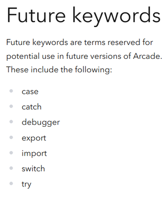

jrosacker
Interestingly, Esri has reserved some relevant keywords in Arcade:
Hopefully this idea gets approved!
