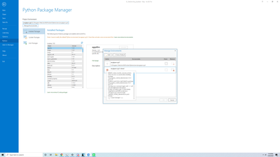

BSplitt
Hi, when I try to clone the environment, I get this error. I've read on other websites that users have resolved this issue by running ArcGIS Pro as an administrator, but I'm not sure how to do that. Any help here would be great.

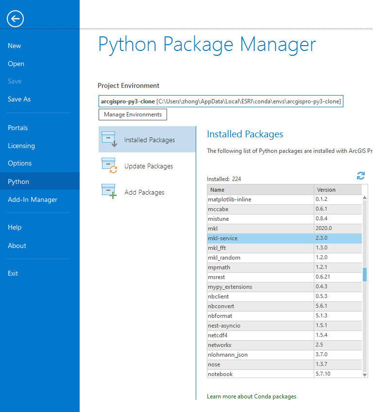

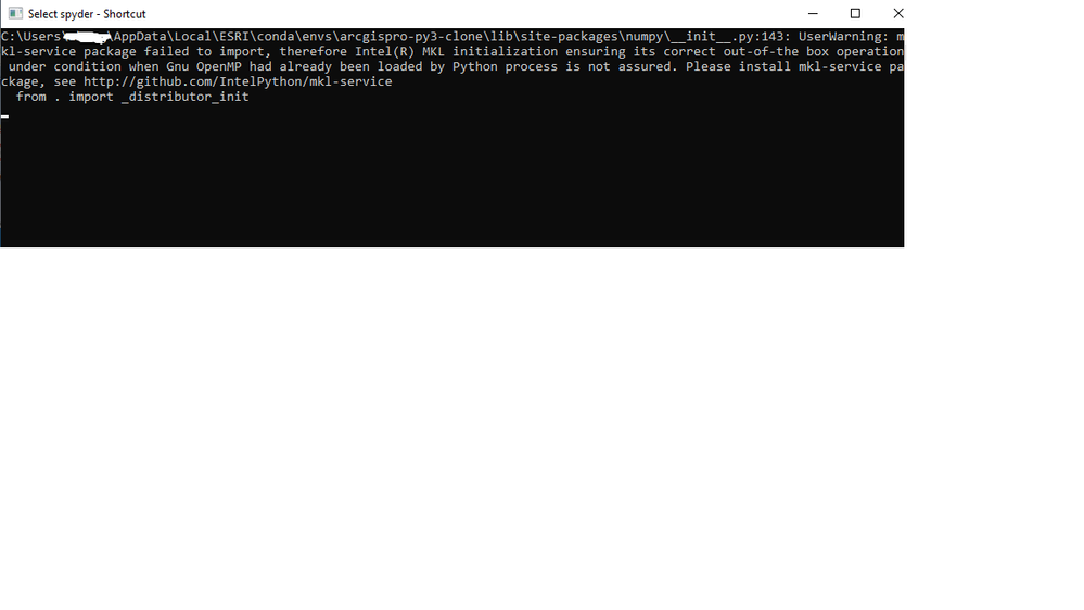

zhongying_gan
Hello,
I have installed spyder according to the tutorial. However, when I ran it, there was the following message and I was unable to run spyder. Any comments will be greatly appreciated. Thank you.
Brian_Wilson
Honored Contributor
It looks like it wants you to install the package "mkl-service"
Can you tell us what ArcGIS Pro version and what Python version you are using?
I remember hitting this back some time, and I read that mkl-service needs python 3.7 which I believe comes with Pro 2.8. Are you still running Python 3.6?
In Pro, Project -> Python -> look at the list of installed packages, see if mkl-service is there. If not, try using Add Packages and type in mkl-service and see if it shows up.
Or do it all using "conda" at a command line if you know how to do that. On my computer it looked like this
conda install --name=arcgispro-py3-vscode mkl-service

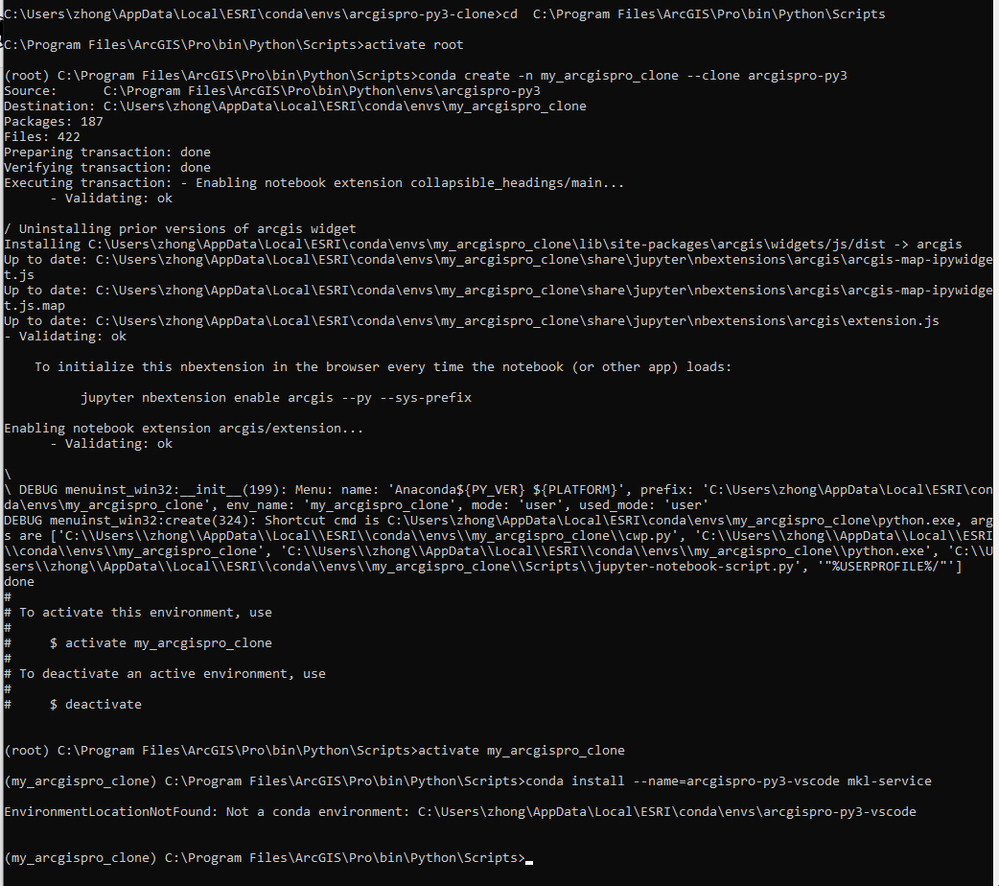

zhongying_gan
Hello,
Thank you for replying. My python version is 3.8.8, and my arcgis pro version is 2.8.2.
The mkl-service is installed in arcgis pro(mkl-service.png).
I followed https://medium.com/@ianmcintyre_38849/creating-custom-conda-environments-in-an-arcgis-pro-workflow-1... up until the line "activate my_arcgispro_clone". And then I typed
But I received the following error:
I would really appreciate it if you could share with me your thoughts on this. Thank you.
Brian_Wilson
Honored Contributor
You already have mkl-service so you don't need to install it
What happens if you do this?
conda activate my_arcgispro_clone
conda install spyder
(Once you have activated an environment you don' t have to use the "--name=" option)
If you have some other version of Spyder installed (like from a separate installer) then you probably want to remove it before installing again with this.
What this is doing is telling conda to install a copy of spyder inside its active environment.
It should also show in your start menu with the environment after it, so for you it should show as
spyder (my_arcgispro_clone)
Clicking on that should be enough to load the environment and launch spyder.

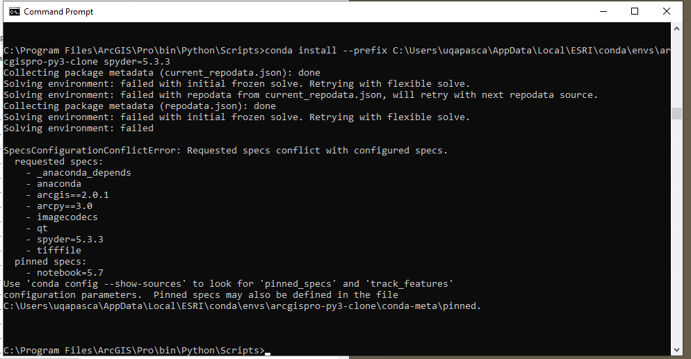

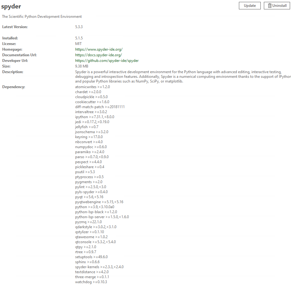

Andrew_P

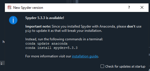

Hello Duncan and All,
I have referred to this feed multiple times when reviving the Spyder IDE for use with ArcGIS PRO after a PRO version update has broken its functionality (grrrrrr).
I assumed that I would be able to get Spyder working again after an upgrade to PRO 3.x today (first mistake).
I can get Spyder 5.1.5 installed and working in general.
However, Spyder 5.1.5 has a bug which crashes it if you have an input() command in your code [https://github.com/spyder-ide/spyder/issues/17616] - which I didn't know before upgrading to PRO 3.x, and appears to have been fixed in Spyder 5.3.0.
Despite seeing 5.3.3 in the update list in the PRO Package Manager, I can not get the PRO package manager to install the update. Nor can my newbie-ish python skills get conda to update/install 5.3.3 from the command line (see attached screenshots).
It appears that my two choices when starting again fresh tomorrow morning are:
1) Revert to PRO 2.9.x and install and get Spyder working again using Duncan's original post - which will likely break my main project file, which PRO has helpfully 'ugraded to 3.x' and I stupidly accepted... second mistake;
2) Hard code all input() requests in my python code - and hope that no other bugs in 5.1.5 keep the code from running in Spyder;
3) move away from Spyder and use another IDE, although a brief foray into getting other gui-based IDEs working yielded little useful in my scramble today.
Any and all thoughts on my conundrum would be appreciated.
[UPDATE on 26/09/2022 - still no fix for core issue; was able to get the PyCharm IDE set up an working using this link - https://epjmorris.wordpress.com/2020/09/16/configuring-pycharm-for-use-with-arcgis-pro-and-arcmap/ -  (Thanks Grace!). Not ideal but a workaround. Better that people avoid the inconvenience and wait until the bugs in the PRO 3.x - Spyder 5.x interface are worked out. I will add an update to this post if I stick with PRO3.x and Spyder updates and starts to work, or I revert to 2.x in frustration!]
[UPDATE on 03/10/2022 - still no fix for core issue; still running PyCharm. Did some checking against the spyder update list (see third screenshot) and these items - and their dependencies - seem to be holding the spyder 5.1.5 -> 5.3.3 update up in PRO 3.x Package Manager (PM):
* ipython >=7.31.1,<8.0.0 [8.4.0 available in PM, but cannot update; appears to need less than 8.0.0 so need to be able to install older version until spyder 5.x accepts versions >8.0.0]
*python-lsp-black >=1.2.0 (1.2.1 available in PM, but cannot update)
*python-lsp-server >=1.5.0,<1.6.0 (1.5.0 available in PM, but cannot update)
*spyder-kernels >=2.3.3,<2.4.0 (2.3.3 available in PM, but cannot update)
*pyqtwebengine >=5.15,<5.16 (not available in PM? Need to install for spyder5.3.3 to work?)]
Thank you and Kind regards,
Andrew
Screen Shot 2022-09-20 at 15.07.01.pngScreen Shot 2022-09-20 at 16.23.29.png
Spyder update dependenciesSpyder update dependencies
