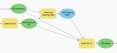

I've been working on a problem lately, and discovered that there was no out-of-the-box way to achieve this. In short, I have 2 feature classes going into a Spatial Join, but the fields in those feature classes could change each time the model is run. The issue here is that the Field Map in the Spatial Join tool is static, and can only be updated by editing the model, running up to the Spatial Join, opening the Spatial Join parameters and resetting the Field Map to include additional fields, or remove those no longer present in the input datasets.
This is obviously not ideal  - Model Builder should be able to deal with this. Enter python script tools!
With a bit of help from a certain AI that everyone seems to know of, I quickly had a python script that when loaded into a python script tool, would take the Target feature class and Join feature class (or as many input datasets as required), iterates through the fields in each and adds them to a Field Mappings object. This Field Mappings object is then passed as an output of the script tool and as an input Field Mappings parameter to the Spatial Join. This then dynamically updates the Field Map of the Spatial Join every time the model is run.
Configuring the parameters of the python script to accept the multiple input datasets and output Field Mappings object, this tool was ready to be added to my model. In short, I now have a reusable tool that when added to any model, will generate a new Field Map for any GP tool that requires it (e.g. Export Features)

This approach could be used to work with any tool that requires a Field Map (e.g. Export Features).

Cool work, but couldn't you have just made the spatial join's field map a parameter of the model?
LindsayRaabe_FPCWA
MVP Regular Contributor
@AlfredBaldenweck Yes! You're right! It could be made even simpler and more versatile. I'll update the original post to reflect this. This is in fact what I had hoped to achieve in the first instance. Thanks for the prod.
