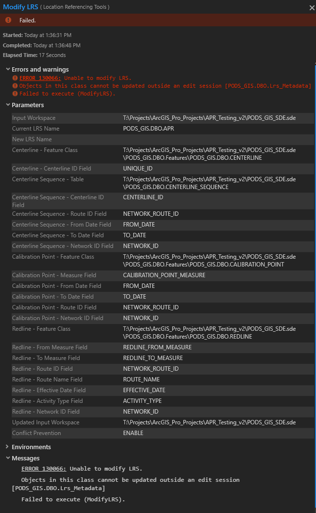

I am attempting to enable Conflict Prevention on my branch versioned LRS dataset. When I run the Modify LRS tool in ArcGIS Pro 2.5.1, I get the following error.
ERROR 130066: Unable to modify LRS.
Objects in this class cannot be updated outside an edit session [PODS_GIS.DBO.Lrs_Metadata]
Failed to execute (ModifyLRS).
I've searched forums for help with this error, and I've found many posts, but nothing really pertaining to ArcGIS Pipeline Referencing and the Lrs_Metadata table. Any help would be much appreciated.

I noticed the documentation Migrate an LRS from a file geodatabase to a multiuser geodatabase recommended to not register the Lrs_Locks table as versioned (which I didn't), which made me wonder if the Lrs_Metadata table shouldn't be registered as versioned. So I unregistered as versioned the Lrs_Metadata table, then re-ran the Modify LRS tool with Conflict Prevention enabled, and It appears it worked. Ayan Palit Can you verify whether Lrs_Metadata should be registered as versioned?
By the way, I did not use a '.' in my LRS name. I named my LRS 'APR'. When I created the LRS in my SQL Server enterprise geodatabase, it added the PODS_GIS.DBO. in front of the LRS name automatically. I'm not sure how to prevent this.
