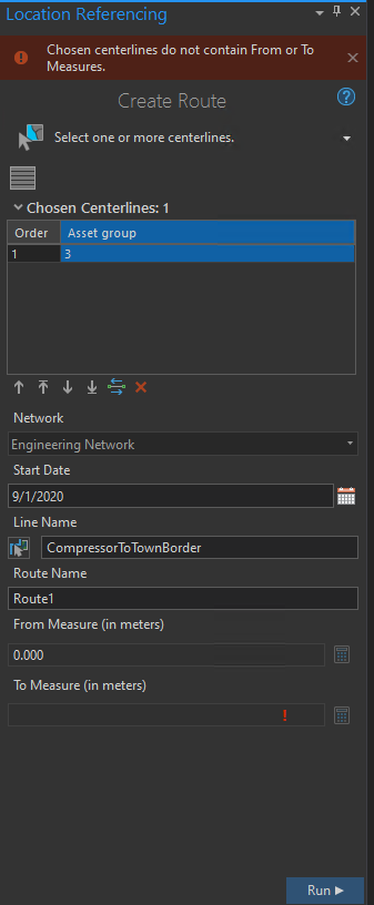

After clicking on the "Create Route" button in the Location Referencing ribbon, I selected a single pipeline line object (a Transmission Pipe segment) which I want to be my first route.
I entered a start date, assigned line and route names then pressed the Run button. Instead of a route, I got an error that says: "Chosen centerlines do not contain From or To Measures."  as shown in this screenshot

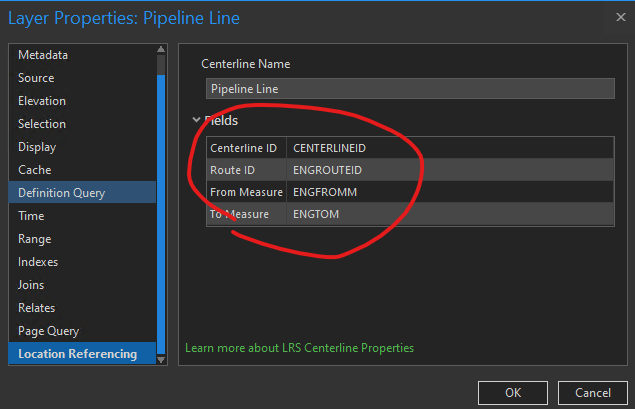

I checked, the Pipeline Line feature class has From and To Measure fields defined, as shown below:
There isn't any data in these fields, they'll all null at the moment.

Michael Nigbor‌ The UN-APR integrated editing workflow is as follows:
  1. digitize the Pipeline Line feature
  2. update the From and To Measure fields based on the survey length or best guess. This will depend on the linear unit of measurement set up, say 0 - 100 (feet).
  3. choose the digitized the Pipeline Line feature to create the route.
  4. you will see that the From and To Measure is auto populated as it is derived from your Pipeline Line feature.

MichaelNigbor1
I'm working with the ESRI-supplied Naperville data, so I don't have actual survey data. To simulate this, I manually From and To values based the feature's calculated length. Now, I'm able to create routes.
Marking as correct answer.  Thanks.
