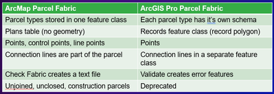

This table shows the differences and some of the confusing and departed concepts:
