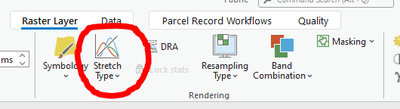

@Lebowski
Try changing the stretch type for the raster layer to none. Select the raster in the contents pain and if you're using 3.0x it's on the Raster Layer tab. If you're using 2.9x, it's on the appearance tab. The Stretch Type setting is in the Rendering group.
Hope that fixes it!
