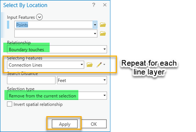

My current understanding of the requirement: select points that are not used by any connections lines, not used by any parcel type lines, and not used by any historic parcel type lines. Depending on the subsequent action, control points may also need to be excluded from the resulting set.
When I first tried this on Friday I found this is not as easy to do in a map with multiple parcel types. In working on this again today, I found the following approach worked:
  1. Select all points in the points layer. If you want to exclude control points from the final selection then start by only selecting points that are not control.
  2. for each line layer (connection lines, parcel type lines, historic parcel type lines) use the Select By Location to remove from the selection, using following the approach. Press Apply after each layer to keep the dialog up:
This could also be automated via python scripting.

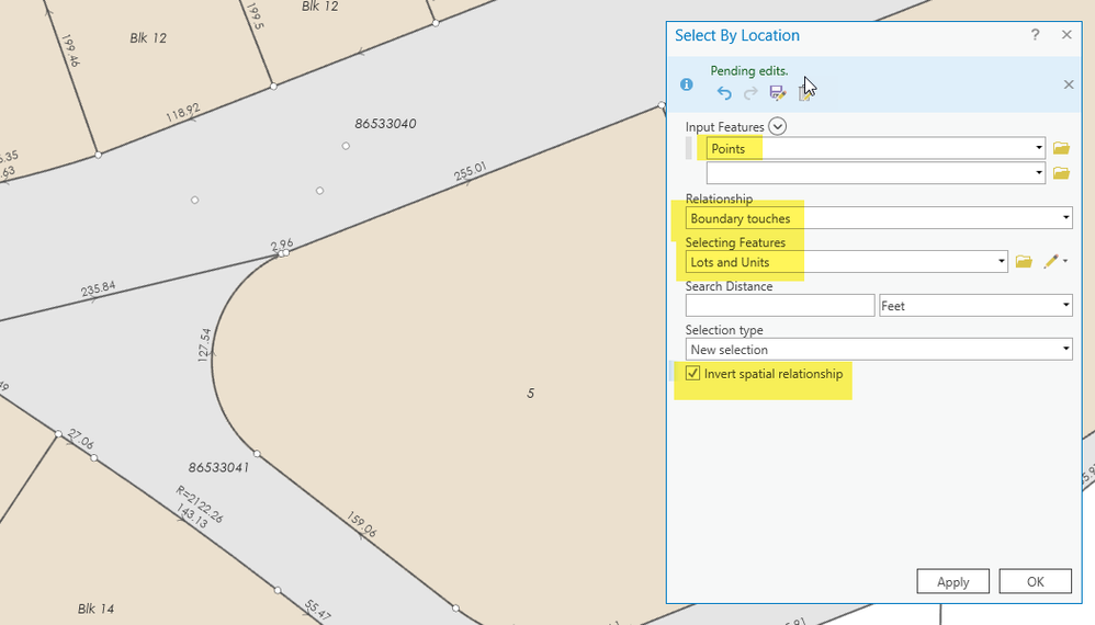

AmirBar-Maor
Hi Chad,
There is a very simple way - use Select By Location.
I have used the parcel polygons layer because it is smaller and the "Boundary Touches" method.

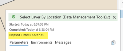

It took 6 seconds on a layer with 43K parcels

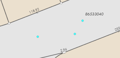

It selected the correct points:
Is this easy enough?
TimHodson
