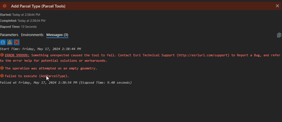

Unfortunately I am still getting Error 999999. Here is what I did.
1. The service was already stopped so  I went into the parameters and unchecked 'Lock Database Schema'
2. I started the service.
3. I disabled versioning on the Parcel Fabric dataset.
4. I right clicked the fabric in the engerprise geodatabase > Manage > Add Parcel Type and used the name "Subdivisions"
This was the result:
Did I miss a something?
MDB_GIS
Welp. A bit embarrassing as it was an obvious error on my part in hindsight. While the feature dataset connection was set to branch versioning, the database connection file was set to traditional versioning. We are currently in a transition phase to portal, so we are in a mixed versioning environment. I thought that dataset level version setting was what mattered, but obviously not. Thank you for your help!
