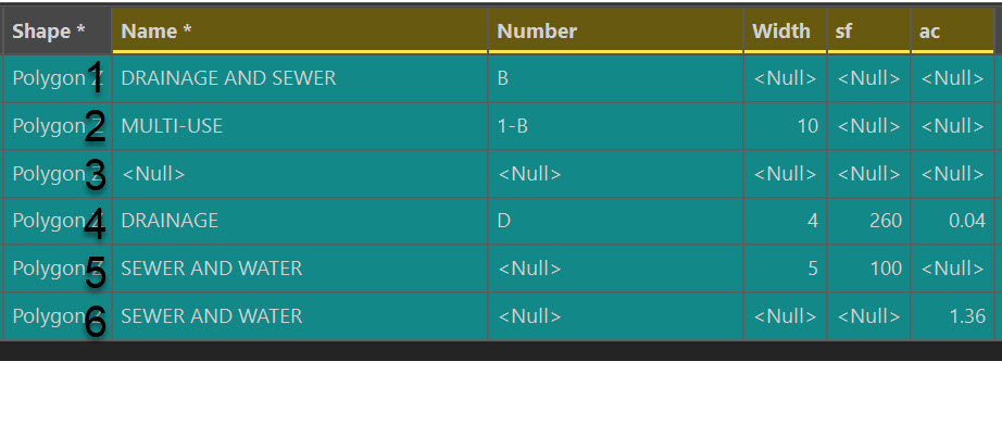

Fields: Name, Number, Width, sf, and ac.
We are not using the default StatedArea/StatedAreaUnits fields because our legal descriptions frequently contain both square feet and acres and we want to reflect that in our Tax Map Sheets.
  1.  DRAINAGE AND SEWER ESMT B
  2.  MULTI-USE ESMT 1-B (10 FT WIDE)
  3. ESMT
  4. DRAINAGE ESMT D (4 FT WIDE) *NEWLINE* [260 sf or 0.04 ac]
  5. SEWER AND WATER ESMT (5 FT WIDE) *NEWLINE* [100 sf]
  6. SEWER AND WATER ESMT *NEWLINE* [1.36 ac]

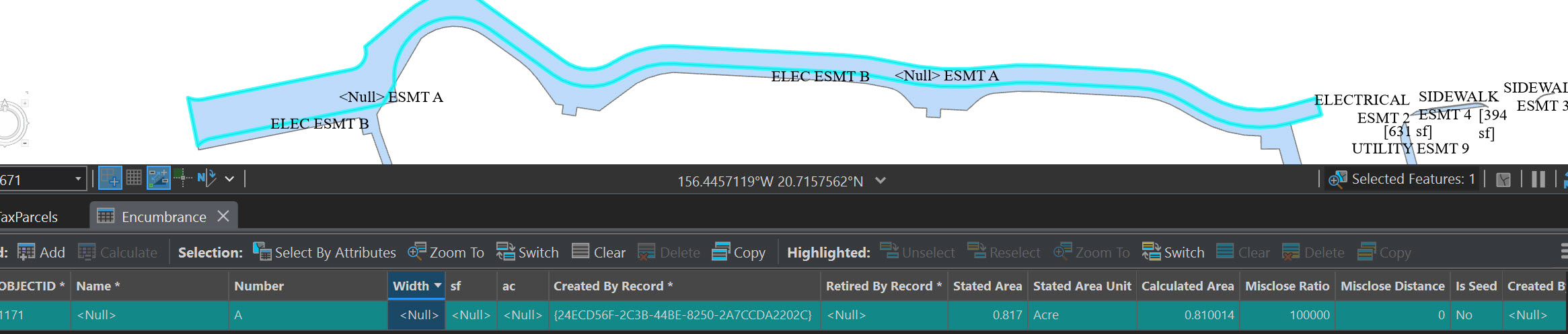

There is also one issue for the Name/Number portion.. I can't figure out how to prevent "<Null>" in the Name.

Is the value literally "<Null>"? Regardless, we can filter for the literal string, too. Be careful that you don't use a function name as a variable, as is the case with Number here.

ElisseDeleissegues1
function NotEmpty(x) { return !IsEmpty(x) && x != '<Null>' }
// name and number, filtered out if empty
var name_num = Filter([
  $feature['Name'],
  'ESMT',
  $feature['Number']
], NotEmpty)
// join valid attributes with spaces
var name_num_label =  Concatenate(name_num, ' ')
// include "FT WIDE" when width is present, otherwise null
var width_label = Iif(
  NotEmpty($feature['Width']),
  `(${$feature['Width']} FT WIDE)`,
  null
// array of area values, empty values filtered out
var area_arr = Filter([
  Iif(
    NotEmpty($feature['sf']),
    `${Text($feature['sf'], '#,###.##')} sf`,
    null
  Iif(
    NotEmpty($feature['ac']),
    `${Text($feature['ac'], '#,###.##')} ac`,
    null
], NotEmpty)
// join area values with space and brackets; if no values in area, omit entirely
var area_label = Iif(
  Count(area_arr) > 0,
  `[${Concatenate(area_arr, ' or ', ' ')}]`,
  null
// all labels in single array, filter out empties
var final_arr = Filter([
  name_num_label,
  width_label,
  area_label
], NotEmpty)
// output labels one per line; if <br> doesn't work, try '\n'
return Concatenate(final_arr, '\n')
That's a completely different language! lol
I made a few small changes adding parentheses to `(${$feature['Width']} FT WIDE)`, and "or" to the area concatenation `[${Concatenate(area_arr, ' or ', ' ')}]`,
and this works exactly right!! 😀
This is what my users want to see and I thank you very much
I do wish I was better at these things....but I'm learning👍
