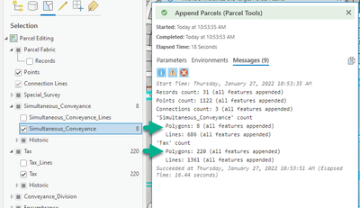

@anna_garrett  this should be out with ArcGIS Pro 3.0.
Here is a sneak peek:
anna_garrett
@AmirBar-Maor that looks awesome!! hopefully this will stop some headaches!
AmirBar-Maor
Status changed to: Implemented
With Pro 3.0 you can view the number of features that got appended for each parcel type as well as points and connection lines.
@anna_garrett one less reason to get a headache while appending parcels 😉
