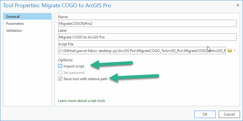

So one thing I seemed to have found that stops the issue is to right click on the Script Tool and go to Properties.  On the General tab uncheck the box that says Import Script.  It will then bring up windows browser.  If you can browse to the area where the tool is downloaded you will browse to a .py file.  Just click that and click OK to the windows explorer. Then click OK to the overwrite message.  Now run the tool again and it should run fine.
I'm looking into what importing the script does that's causing issues.
WileyBogren
Yes, looks like this property change works!

If you save the toolbox with Import Script turned off and Store tool with relative path checked on then just store the script in the same folder as the toolbox and that should work.  Then everyone can just point to the location where the toobox is located and run the tool.
WileyBogren
Works!
Thank you, Jason!

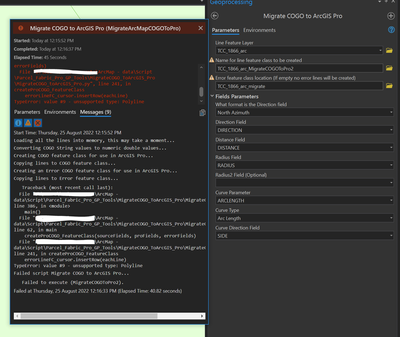

Hello, Jason - I am attempting to convert our ArcMap COGO lines to ArcPro COGO lines using your tool, but everytime I try to do so I get the error "Cannot find field 'shape.len'. Any suggestions?
JasonCamerano
Hey @Mike_Fazio_SRCPA
Would you be able to email me the data (or a portion of the data)?
Is the data on a FGDB or SDE database?
My email is [email protected]
I'll take a look at it.
Thanks!

Mike_Fazio_SRCPA
Thank you @JasonCamerano . I sent you an email with a sample dataset. Please let me know if you have any issues with the format.
Regards,
Mike F.
JasonCamerano
@Mike_Fazio_SRCPA
I uploaded the newest version of the script to ArcGIS Online site above.  Everything seems to be working on the test cases above that were failing.
The original issue was it was failing when running on data stored on an SDE database.  That has now been fixed and is working as expected.
Good find Mike! Thanks!
