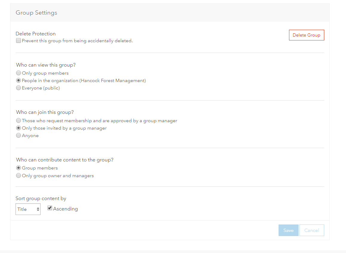

I see no setting about Update Capabilities.  Where is that on the Group settings page?
I see a slight difference in the settings page but no idea how to change this.
Group does not show page
Group does show page

Ok I found that the setting is only when you create the group.
I still dont understand why a group is not listed when setting to All Items.  What does one have to do with the other?
Can i not have groups members update ability and then share it to a 2nd group?  And if so why not?
