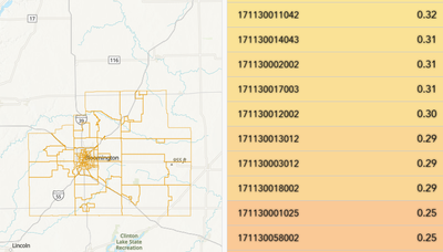

So maybe the symbology itself can't change based on an ad-hoc field, but we can use a Data Expression to get the Dashboard to treat our calculated fields as though they were "baked in". Here's an example of using a List with a Data Expression.
Esri's census features have their own "diversity index", but I wanted the Simpson's Index of Diversity, which wasn't in the layer. So I used a Data Expression to create it as a field, and was then able to alter the color on my List using the calculated index.
Not as good as changing the symbology itself, but it's at least something.
