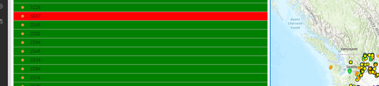

We have the dashboard now with a data expression as you posted.  It turns rows red if a matching error report is found in the Error form layer.  And now with the Geometry(f) part right it will even change on zoom which is sweet.  thanks on that.

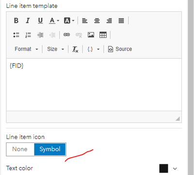

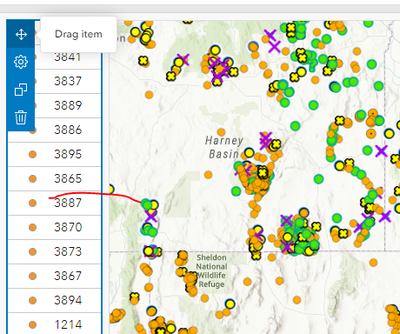

Do you know how to get it to use the same symbology as the map in the list?  It works when its a layer but when it goes to data expression it changes all the symbols to the same symbol.  I think it may be the no value symbol from the map.
In the properties all I see is symbol on/off.
Is there a way to say hey use the symbology from over on the map?  It is that or we have to recreate it in Ops using a big if statement I guess.

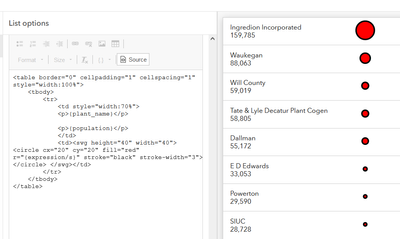

Yeah, I don't know if the FeatureSet comes in w/ default symbology. According to the REST docs, a Feature can come in with a Symbol property, but I don't recall ever having seen that in Arcade...
A workaround I've used is to use SVG elements and pipe in attributes to them. Like here, I have a list of features and I wanted graduated symbols in the List.
I had to use Advanced Formatting to scale the attribute to a pixel size that made sense, but I was satisfied with the result. Though a bit tedious, you could find SVG versions of the symbols you like, then pipe those into an expression with When(class_a, "svg string", class_b, "other svg string"...)
