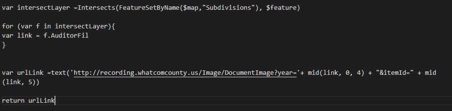

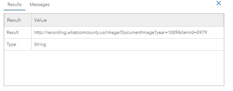

I'm configuring a basic pop-up within a Web Map using Arcade expressions.  For one of them I build a URL from an intersecting layer which is passed through to an image to be clicked.  When I test the expression the result is what is expected.  However, when I click on the image to which the expression is attached the URL is returned with "amp;" added directly after the "&" which breaks the link.
And test results:
Actual passed URL:
http://recording.whatcomcounty.us/Image/DocumentImage?year=1889&itemId=5979
I've tried UrlEncode() on both the full string as well as just the & and while it does encode the URL does not work.  I've also tried encapsulating in text() but the & still gets converted at some point.

I'm trying to replicate the problem, but I am not able to. No need to encode or use Text to get the correct URL. I'm using this code to test:
var link = "1889x5979";
var url = "http://recording.whatcomcounty.us/Image/DocumentImage?year=" + Mid(link, 0, 4) + "&itemId=" + mid(link, 5);
return url;
And the result does not include any &
