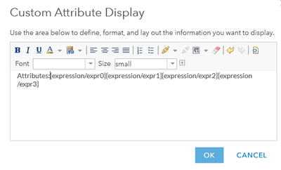

Then in the popup configuration, put all the expressions on the same line. The \n in the returned string will separate multiple values.
To show what this might look like in practice, I'll use a static dict instead of the feature's attributes so that you can see the skipped values. My input:
var d = {
'first': 'the first value',
'second': null,
'third': null,
'fourth': 'and the fourth'
And the popup configuration:

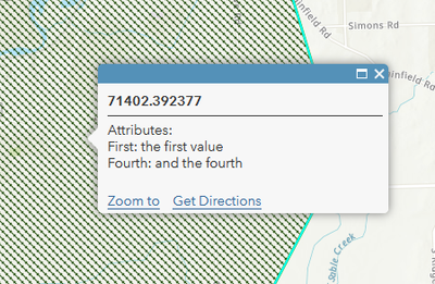

And the resulting popup:
You'll have to do extra work if you want the output to look nice or have a tabular alignment, but this can at least give you a list of non-null / non-empty attributes in your feature that won't leave blank spaces.
EDIT: It occurred to me after posting that that there's no need for multiple expressions. If you build a dict from the attributes you want, you can return a single string with all the attributes in one go:
var attrs = {
    'First': $feature['attribute1'],
    'Second': $feature['attribute2'],
    'Third': $feature['attribute3']
out_str = 'Attributes:'
for(var a in attrs){
    if(!IsEmpty(attrs[a])){
        out_str += `\n${a}: ${attrs[a]}`
return out_str

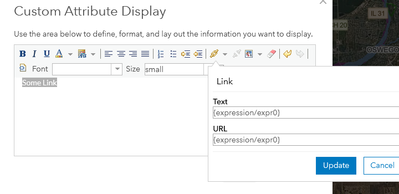

Well, that is a very different thing. If you want clickable links, you have to do it one expression per field, there's just no way to get the "<a href=...>" HTML tags into a dynamic list within a single expression. Configuring a popup to show "<a href={expression/expr0}>{expression/expr0</a>" works, where the expression returns a valid URL.
However, if the popup was "{expression/expr0}", where the expression returns all the <a href...></a> tags within it, that will not work, as the HTML tags will be read and displayed as text characters. With that in mind, you could try:
  1. Write an expression for each URL field that only returns something if there's a value.
  2. In the popup, define a link to have the text and URL come from that expression.
There's no way to get the newline character into the link, however, so you'll be once again stuck with either a really long horizontal string of text, or a tall list with empty rows.
Add to this the fact that your URLs may be long, and you may wish to display some other text. If you wish to do that, you'll need TWO expressions per field, one for the URL, one for the link text.
