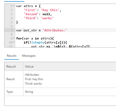

EDIT: It occurred to me after posting that that there's no need for multiple expressions. If you build a dict from the attributes you want, you can return a single string with all the attributes in one go:
var attrs = {
    'First': $feature['attribute1'],
    'Second': $feature['attribute2'],
    'Third': $feature['attribute3']
out_str = 'Attributes:'
for(var a in attrs){
    if(!IsEmpty(attrs[a])){
        out_str += `\n${a}: ${attrs[a]}`
return out_str
- Josh Carlson
