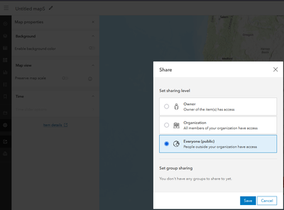

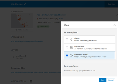

sjeffs24
sjeffs24
sjeffs24_0-1630913852779.pngsjeffs24_1-1630913897852.pngsjeffs24_2-1630913947262.pngsjeffs24_3-1630913965561.png
What am I missing except the app?
