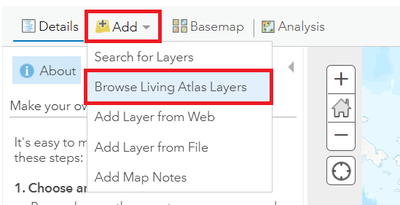

Hi Everyone,
I just started learning ARC GIS. I follow Esri's "getting started with GIS course. at the very first step , when I want to search for the layers, nothing shows up. Do I have to do something before that?  I attached a snapshot for your information.
Thanks
Elee
JayantaPoddar
MVP Alum

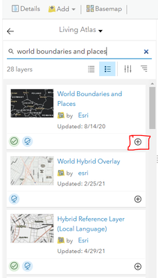

You need to select "Browse Living Atlas Layers" from the "Add" dropdown options.
"Search for Layers" will only search search the layers within your Content/ shared with your Organization.

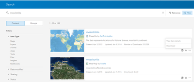

Also in case you want to search for content that is published by other ArcGIS Online users for public, you could use the search button from your AGOL Homepage (Top Right)
