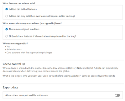

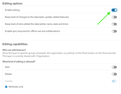

I have a view layer who's schema is configured to be editable, but members that are data editors still can't edit it. Even the parent's schema is configured to be editable. The members can edit the parent, but they can't edit the view for some . Because in the future I want them to only edit the view, this will be an issue. Below, I attached the schema configuration.

  • The Missing Toggle: In your View Configuration image (image_c677c1.png), you have "Enable editing" turned on, but you have to check the individual capabilities. If "Add," "Delete," and "Update" are not toggled on within that specific View’s settings page, editors will be blocked even if the parent layer allows everything.
  • The "Primary" Source Rule: Notice the blue alert in your image: "Setting must be configured on the hosted feature layer that this feature layer view was created from." While you can restrict a view further than the parent, you cannot make a view more permissive than the parent.
  • The Solution: Go to the Settings tab of the View Layer (not the parent). Scroll to the "Editing" section. You need to ensure that the toggles for Add, Delete, and Update (specifically "Attributes and geometry") are actually flipped to green. Currently, your image_c67a68.png shows these settings, but if that screen is from the parent and not the view, the view is likely still defaulting to "Read Only."
Double-check that you are on the Settings tab of the View itself. If "Update" is toggled on but "Attributes and geometry" is not selected, editors often get stuck.

Just to clarify, the screen shot I sent is from the view.  Add and Delete are intentionally not on. I don't want members to be able to delete and add features. I just want them to be able to update features from the view. Update is toggled on. I actually can't turn it off, as it is grayed out, as seen in image.

It looks like Editing is enabled properly. I think you said that some can edit the view. Is that the case?
  • How is the layer shared (org/group/everyone)?
  • What app are they using for editing?
  • What happens when they try to edit the view layer?

Can you try this in the Settings for the View layer:
  • Toggle off Enable editing.
  • Toggle it back on.
  • Test to see if editing is enabled.
I'm happy to have a look at the layer if you can share it with me.
