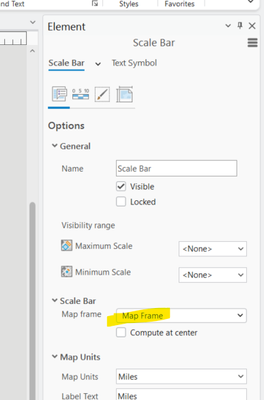

ZaraMatheson
Hi Steve, Can you double check what you have set in the Map Frame drop down for your scale bar? If I reference the map Frame in my layout that gets populated in ArcGIS Online, the scalebar updates to match the scale in AGOL. If it is set to none or some other map frame that does not match what is being printed in AGOL, it will not update.

ZaraMatheson
SteveMasters
Thank you for the prompt to look at this, it is now solved and working.
