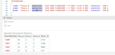

In GroupBy, the "expression" key is specifically looking for valid SQL.
@JasonBatoryin your series of expressions, you're treating the "expression" like it's a filter. In GroupBy, it's going to attempt to return the statistic from the expression, and you can't really count whether or not the floorcount is equal to a value.
To use @CodyPatterson 's idea, but in SQL, you can use CASE:
"CASE WHEN FLOORCOUNT = 0 THEN 1 ELSE 0 END"
Use that with the statistic "SUM", and you'll get the number of records with that particular floor count value.

JasonBatory
Ok, this makes sense now. I also tried "WHERE FLOORCOUNT = 0" with count statistic, but I see this should be treated more like a decode situation using the sum statistic.
Thanks for your help Josh, and Cody.
