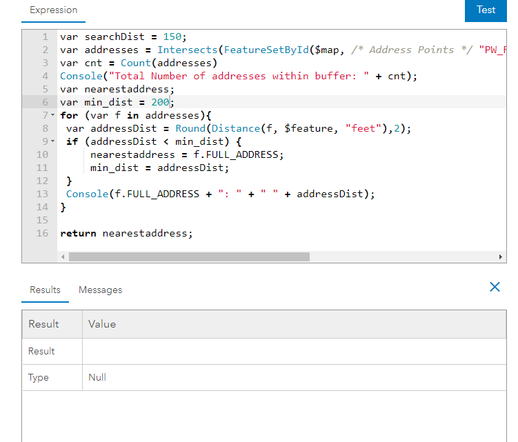

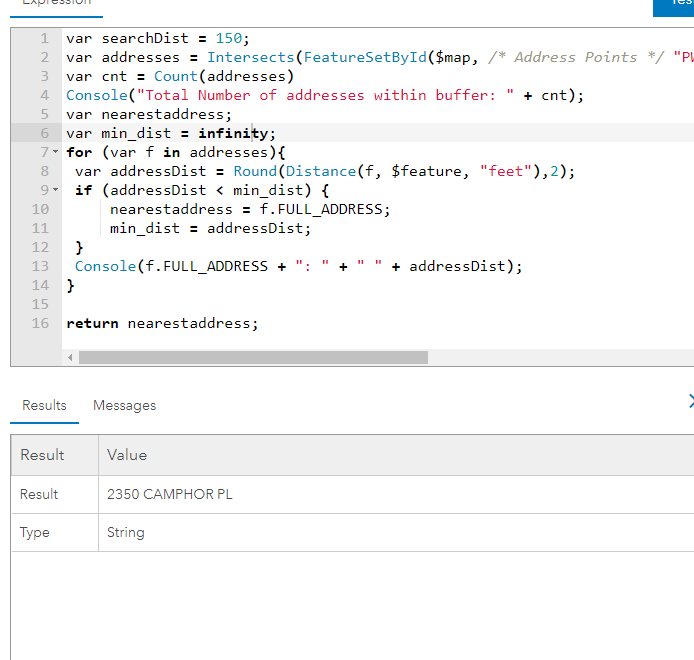

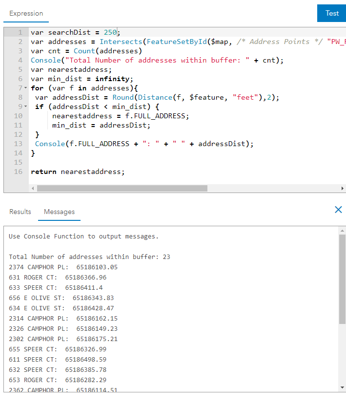

Hi @XanderBakker ,
Thank you for your help. I have tried using your code and ran into several weird issues. When I set min_dist to a value the result I get is null. This has lead me to set it to infinity as shown in this esri resource Find nearest features using Arcade expressions in a popup | ArcGIS API for JavaScript 3.40 | ArcGIS ... .
When I set to infinity I get a result but it is often not the nearest address distance wise. And it changes if I use a higher search distance which doesn't make sense. I also get large numbers for the address distances.
The $feature is being hosted in arcgisonline while the address points layer is a registered feature layer.
Do you have an idea as to what may be going wrong with my version? Thank you for your help again! console_results.pngconsole_results.pnginfinity_1.pnginfinity_1.pnginfinity_2.pnginfinity_2.pngnullval.pngnullval.pngI have attached some photos for reference
XanderBakker
Esri Esteemed Contributor
Hi @OliverSandoval_p ,
Sorry for the delay, but when I look at the distances that you get I wonder how big your feature is... Distances of 65M feet are about halfway around the globe.
If I use Infinity or the searchDist as the initial minimum distance it will return the same result:
OliverSandoval_p
hi @XanderBakker ,
The issue ended up being the web map's web Mercator projection while the hosted feature layers were in NAD 1983. I had to reprojection the data needed because end users needed to have more than one basemap and I didn't have time to create a custom basemap.
Thank you for your reply!
