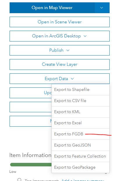

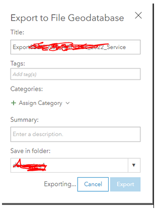

We collect a lot of photos.  Every year just after the service hits 10GB the Export to GDB starts to fail.
It will sit like this Exporting for hours.  Then the Export button goes back to not greyed out and clickable again.
The resulting file that is created is way smaller than it should be.
