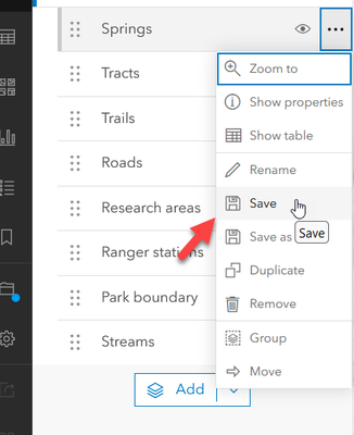

hi @BillSands if you want to be able to have your feature layer preserve the settings without having to reconfigure it again and again,  you can do this by going to the layer's overflow menu and clicking "Save." Popups, symbology, forms, etc will all be saved to that feature layer item so any time you bring it into a map you'll have the same starting point!
You can then bring it into a new map and make any changes and save to the map itself. This allows you to override the feature layer's saved settings on a map by map basis.
