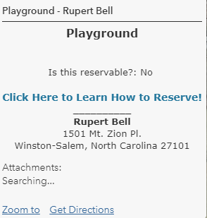

I am trying to get a hyperlink to show only if the feature is "Reservable." (This layer deals with Picnic Shelters and Playgrounds).
I've created an expression that creates a hyperlink if it is reservable, but I don't want the hyperlink text to show up at all if it is not able to be reserved. See pictures for a little bit more context.

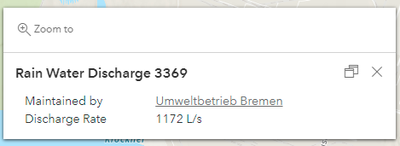

In the meantime, something like this works (switches between showing a google search link or plain text depending on whether the discharge is maintained by a public authority/company or a private citizen):
JohannesLindner_0-1646637834090.pngJohannesLindner_0-1646637834090.pngJohannesLindner_1-1646637848643.pngJohannesLindner_1-1646637848643.png

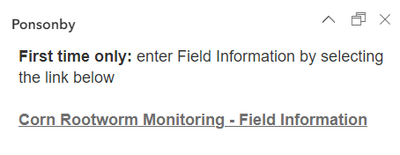

When Survey A has not been submitted
I would like to add the text "You have not submitted your Field Information Survey yet.  Please submit your Field Information first."

JohannesLindner
MVP Alum
The expression returns "block" or "none". These strings are used to show (block) or hide (none) the element in the popup's HTML code.
To get what you want, you'll have to create a new expression that returns the inverse of the expression you have (just switch the return values in the IIf function). You can then create a new HTML element before Survey A:
<div style="display:{expression/show_message};">You have not submitted your field information survey yet.</div>
<div style="display:{expression/show_survey_a};">...</div>
<div style="display:{expression/show_survey_b};">...</div>
This solution is for Map Viewer Classic. If you're working with the current Map Viewer, you can also use an Arcade element, do all your decisions in there and return the HTML code.
Have a great day!
Johannes
