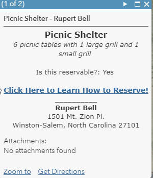

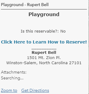

I am trying to get a hyperlink to show only if the feature is "Reservable." (This layer deals with Picnic Shelters and Playgrounds).
I've created an expression that creates a hyperlink if it is reservable, but I don't want the hyperlink text to show up at all if it is not able to be reserved. See pictures for a little bit more context.
Is this possible?

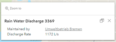

I haven't worked with the new MapViewer, yet.
When I tested right now, it did seem to delete unwanted components in the style attributes of HTML tags, and  I couldn't get a plain "display: none;" to work.
I got it to work with "display: {expression/expr1};", though. I'd have to test more to get an idea of what is and isn't allowed.
In the meantime, something like this works (switches between showing a google search link or plain text depending on whether the discharge is maintained by a public authority/company or a private citizen):
// show_maintainer
// returns "none" if the maintainer field is empty or set to "privat", else "inline"
if(Includes([null, "privat"], $feature.Unterhaltungsträger)) {
    return "none"
return "inline"
// show_private
// same as show_maintainer, only the other way around
    return "inline"
return "none"
HTML source of the popup's text element:

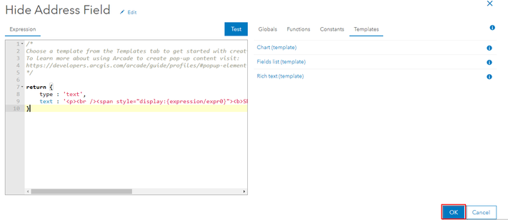

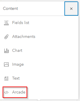

Update: I chatted with tech support about this. Map Viewer has a special "Arcade" content option for pop-ups that you have to use to embed the html code that uses Arcade.
The first part of the workflow is the same - you go to Manage expressions and set up the IIF statement so that it checks to see if your field is empty. Then, you go back to the main config window and choose Arcade from the Add Content menu:
In the dialogue box that opens, you have to put the HTML code in the text parameter like this:
Unfortunately, this new method means that you'll have a blank line in your pop up if there is no data for that particular feature. Here's my example where I'm suppressing empty phone numbers (the Arcade content is in between two text contents:
