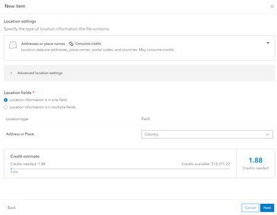

With the CSV you provided I would upload and publish as a feature layer. Under My Content when you click on New Item drag and drop the CSV in and you would match the location using the country field

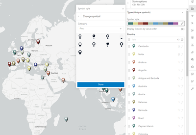

Then on the Feature Layer you create click on Open in Map Viewer. Clicking on the Styles button on the right hand toolbar you can choose how you want to style the features. I did it based off of the country name field and selected a Pin symbol.

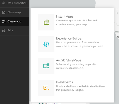

You can then go to the effects tool and apply a drop shadow like I have in the pic above. Saving the web map will then let you create an app from the map.

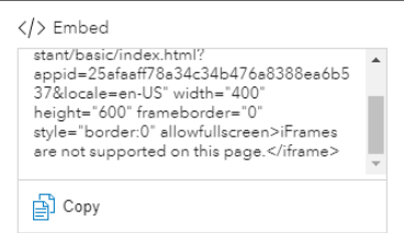

Then you can create a simple web and use that on your site.  I would recommend using Instant App basic viewer after you publish with that you would have to update the website with the embed snippet that's automatically generated for you in the instant app builder.
