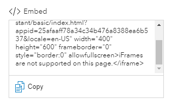

Thanks Russ. Just to be clear, since I'm far from fluent in ESRI lingo, the ESRI map that appears in this page (https://eden.enterprises/pristine-parishes) is the wrong type of client? I ask because it produces the error message I referred to. If so, please could you point me to a page that tells me how to insert a different client on the Eden site, since I have long forgotten how I managed to do so!
RussRoberts
Esri Notable Contributor
Yup this is a web app builder application: https://edenenterprises.maps.arcgis.com/apps/webappviewer/index.html?id=0d74c778bc24454da402b96322a3...
I would recommend using Instant App basic viewer after you publish with that you would have to update the website with the embed snippet thats automatically generated for you in the instant app builder.
https://doc.arcgis.com/en/instant-apps/latest/get-started/create-and-publish-apps.htm
GrayElkington
Your advice was easy to follow, Russ. The Eden site now features a new map complete with embedded media, so many thanks. You have definitely made my Easter a happy one!
