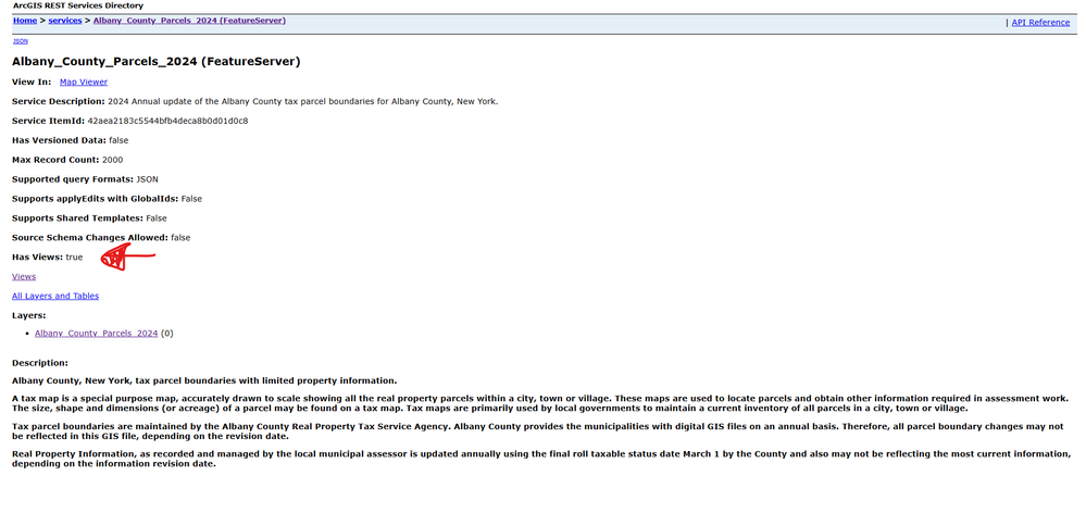

Attached is the rest service page, which can be accessed from the link at the bottom right of the item details page. You can see it still is showing that it has views for some reason. That was the only trick in my bag. Might need to reach out to support.

Support was able to resolve this issue.  Somehow this feature layer still had some "ghost" views associated to it.  I had deleted all of the views that were created from the feature layer yet when I viewed the REST Services Directory, layers details page>click view next to URL on bottom right.  Here it was showing views associated to the feature layer.  When clicking on the view, it could not be found.
ESRI had to remove the "View" on their end to fix the issue.

That's odd. The service is still showing that is has that view, even though the referenced view doesn't exist. You might need to try updating the definition to reflect that it no longer has a view. The definition should have updated on its own when you deleted the view, but clearly not this time.
