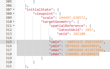

Nevermind. I did some more searching and it appears the only way to do this now is within AGO Assistant. Here's how:
  1. Head to https://ago-assistant.esri.com/ and log in.
  2. Click "I want to..." then "View an item's JSON"
  3. In the left, navigate to the map whose extent you're looking to copy. Select it.
  4. The right will populate the item's JSON. Under 'Data,' you're looking for a code block that looks like this, probably toward the end. (Ctrl+F and search for initialState or viewpoint, etc.)rburkebsrc_3-1646255835460.pngrburkebsrc_3-1646255835460.png
  5. Copy the 4 lines that include xmin, ymin, xmax, ymax (like above).
  6. Navigate to the other map(s) that you're looking to copy the extent to. Click "Edit JSON" in the top right of the Data box. Find the same code block and paste the values over those 4 lines. Save, repeat for any other maps, and you're done! You'll still need to be careful to click "Home" before each time you save, or re-do these steps if you accidentally bump it.

Yup this is bc the application creates the extent based on 3.x older spec and the 4.x has been updated to use viewpoint. If we update the extent app to move to the New Map Viewer way this would impact classic based map viewer maps using this widget to define the extent.
