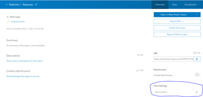

Hello! I am new to ArcGIS online and I am trying to create a timeslider for my organizations  map to show how different bird colonies are growing over time. However, for some reason the option to enable time does not come up for my feature layer and map, so I am unable to create a timeslider. My data does have dates/temporal data and it is registering it as a date, but it is still not allowing me to view time settings. Is there a way to fix this? I created my feature layer by adding a csv file from my computer to the map. Here is an example of my data and what I am seeing.

I have one layer and I have clicked on the layers details page. I am still unable to see an option for time settings. Attached is what I see from the layers detail page.
