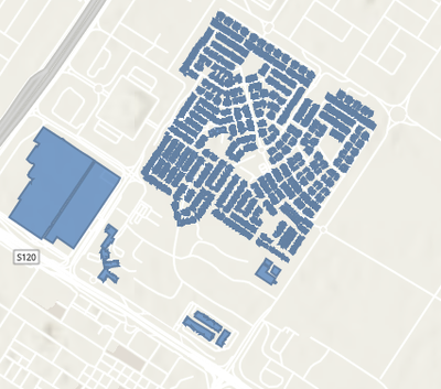

Thanks for the response, here my issue is how do we get joined attributes symbology in feature service when published in ArcGIS online. Please find below variations from ArcMap to Published service symbology. Is there any way to get the same symbology define in ArcMap?

To put it simply, you don't. At least, not initially.
You'd need to export the layer and make the join permanent, then publish that, or you'd need to publish the layers as-is and establish a hosted layer view after the fact. There's no way to use a joined table's symbology in AGOL with the layers being separate.
