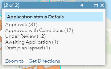

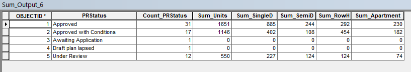

I'm trying to summarize a field in arcade and get statistics from the  other fields for a result similar to this:
Is this possible in Arcade?

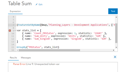

close!!
(FeatureSetByName($map,"Planning_Layers - Development Applications", ['PRStatus', 'Units', 'SingleD'], false)
var stats_list = [
{ name: 'Count_PRStatus', expression: 1, statistic: 'COUNT' },
{ name: 'Sum_Units', expression: 'Units', statistic: 'SUM' },
{ name: 'Sum_SingleD', expression: 'SingleD', statistic: 'SUM' },
GroupBy("PRStatus", stats_list)
Return Stats_list
what  did I miss?
jcarlson
MVP Alum
It should be FeatureSetByName(...), so try taking the parenthesis off of the front. That was a typo in my earlier response.
