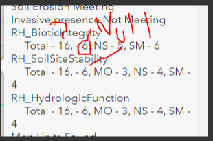

@jcarlson  I have a similar question on OrderBy.  It is showing the total as the first element but with no label.  Then it also does null with no label.  Would be nice if it said Null of course.  But what i want is to not show the total. The help says nothing about a total.  So I figure pop the first element but there is no pop function and Erase will only take array not FeatureSet.  Also Array cannot convert a FeatureSet.
I just want to remove the first one without having to check manually.  I see Top in there but that wont work.

Funny I just posted that "I wish there were an easy way to get an Array from a FeatureSet."  Did you see that one?
But yea I see nothing in the doc that says Order by returns a Total but there it is.
Thanks I will look at it.  For now I just left it in.  Wait just noted that must not be the total.  I dont know what it is number of records??  These are all 16.
What the heck is that first number with no label?
thanks

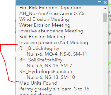

If you look close the second blank number is the Nulls.  I have no idea what the 16 is now.
DougBrowning
MVP Esteemed Contributor
I got this working now and added code for Nulls thanks.  Still no idea what the heck the first number is.  Not in the help that I see.  Weird 16 makes no sense.
