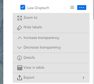

Hi All,

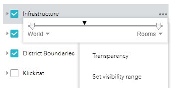

In WebApp Builder, end users could set the visibility range using a slider in the 'Layer List' widget (See Below).
Have they done away with this option in Experience Builder's 'Map Layers' widget? Or am I just missing it?
If it has been taken away, I would love if someone from ESRI could explain why. That was a very useful functionality that allowed a lot of flexibility for the end user of the application.
