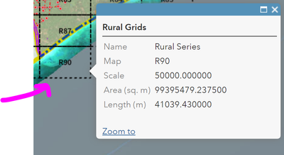

I have published a registered map image layer and a registered feature layer.
When I click features in the map image layer in map viewer classic, the correct pop-up appears for the feature I selected, but the usual vibrant blue selection colour does not appear? E.g. screenshot below, the popup for the clicked feature shows but not the selection.
It does appear on the feature layer, but not the map image. I have compared the settings in server manager on the map image layer with other map image layers which do have the selection highlighted, but all the settings are the same.
Is there something which needs to be enabled when publishing? A particular setting? Any pointers would be greatly appreciated as I've never come across this before!
