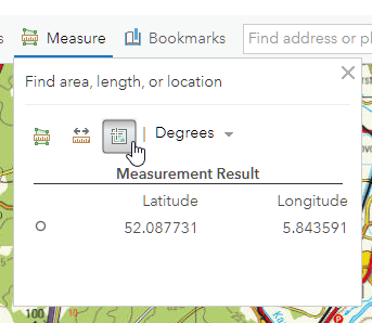

Hello,
I have been working on this all week and I have been searching through the boards, but no luck yet. I can not figure out how to derive latitude and longitude from a historic map I am viewing inside ArcGIS. I enabled the pop-up and it was showing lat and longitude, however, they were the same values for every location on the map. I believe this is available in the Pro version, but I only have 4 locations with latitudes and longitudes I am seeking from a 1906 map.
I have attached a screenshot. I would be very grateful for insight. I am almost ready to offer reimbursement if someone could help me with the latitude and longitude of 4 locations.
BernSzukalski
Esri Frequent Contributor
Unless I am missing something this should be easy. Seems you are using Map Viewer, so assuming the topo is georeferenced all you need to do is open the measure tool, choose the point measure subtool, and click.

DanPatterson
MVP Esteemed Contributor
You will need more than 2 decimal places, you will have to change how the numbers are reported

KenBuja
Is the result in the popup giving you information about the image itself? If so, changing the number of decimal points won't help.
Instead, put this webmap into a Web AppBuilder app, which contains tools to show the coordinates of your mouse position.
