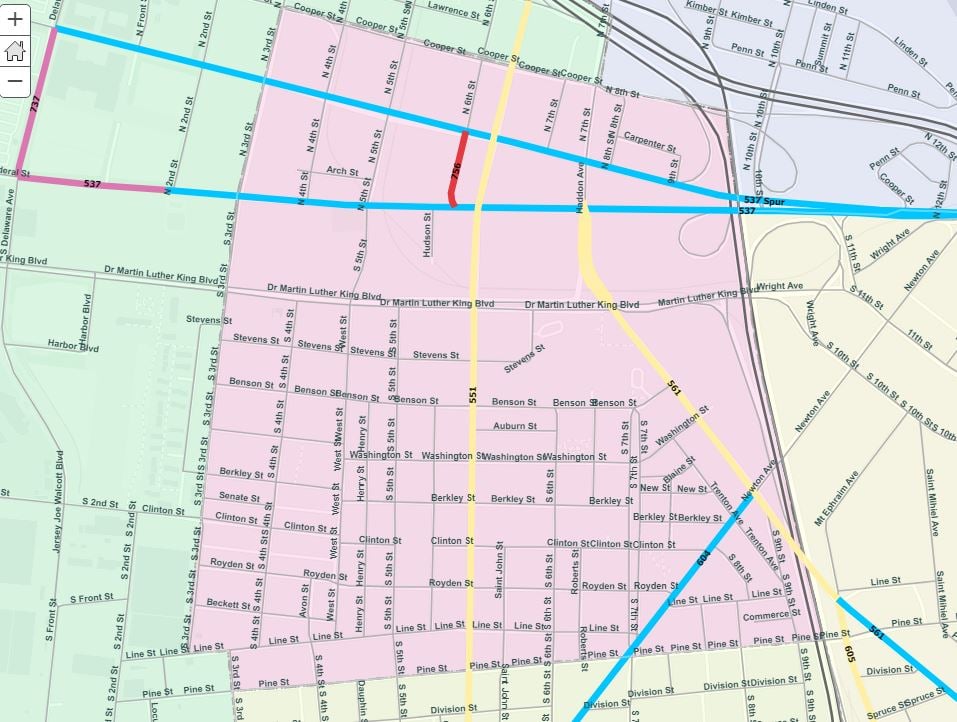

1. When I do this, it removes my "remove duplicate labels" setting on the roads and there are labels everywhere. Is there still not a way to get rid of this issue without using basemap labels? I am using layers where you cannot see the basemap too great and need the roads on top.
2. When I do this, my highway shields disappear for my labels and there are just route numbers everywhere with no shields/symbols. Is there a way to fix this?
3. I have two Neighborhoods layers - same outlines, but 1 has the Neighborhood name labeled and the 2nd one has the tract number labeled. However, when they are both on, it only allows one label and not both. Is there a way to fix this?
Really hoping somebody can give me some direction, I'm at a loss. Thank you in advance.
Screenshot of how many repetitive labels are on the map & missing shields.

I ran into this same issue when publishing the Atlanta street data from Geocoding sample in ArcTutor. This dataset look to be very similar to yours, where each street segment is its very own feature.
ArcGIS online has less powerful labeling options compared to ArcGIS desktop.  I think you could resolve this issue a couple different ways.
1) Run a dissolve on the streets layer to be labeled, this will provide less features to label in ArcGIS online.
2) Publish the layer as a Hosted Tile layer, when the tiles are generated this way they will preserve the labels as placed in ArcGIS Desktop.
Because the tile methodology will be fast and preserve the cartographic quality we achieved using the desktop software its a good option for creating basemap or contextual layers .
Hope this helps!
