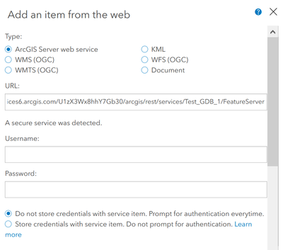

If you go to open it, you'll see it's not shared publicly. But when I go to add it to my AGOL (or in any organization, even another Portal) using the From the Web option, I'll see this:
Saving the username and password with the item prevents any further need to provide authentication to use the service. Unless the user's password changes, that is.

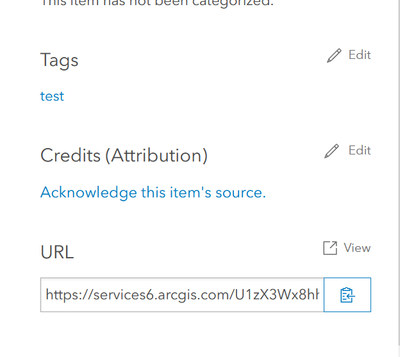

I don't see why it wouldn't. Here's the inverse, me adding a secure service from AGOL to Portal. Just go to the item's details and grab its URL.
https://services6.arcgis.com/U1zX3Wx8hhY7Gb30/arcgis/rest/services/Test_GDB_1/FeatureServer

It behaves the same, i.e. prompts for username/password but then gives an error message after the username/password is entered. It works in the organization where the Feature Later is hosted, just not in any other organization.
