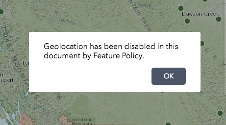

Hi There,
I created an Operations Dashboard with an Embedded Content window. In that window I have a WAB that automatically opens a widget to search for the nearest point feature. The WAB works fine on it's own; however, when I click the "Find My Location" icon on the widget, I receive the message "Geolocation has been disabled in this document by Feature Policy". On my mobile, I receive "User denied Geolocation".
I understand that you can fix this in an iframe by adding allow="geolocation" as per: https://community.esri.com/people/geonb_bernie/blog/2019/08/27/my-location-widget-and-iframes but how do I do this in an Operations Dashboard?

Hi Ben Arril‌,
Thanks for the post - I think the issue you present here is interesting because it looks like the Web AppBuilder app is embedded in the dashboard, then the dashboard is embedded in the web experience. I gave this a quick test on my end, and when accessing the My Location widget in the dashboard before embedding it in the web experience, I didn't see any issues. However when I add the dashboard to the web experience, I do see the issue you are describing.
I think this bug explains that issue: BUG-000129375: Creating a Web AppBuilder application using a Near M..  - if you are able to embed the web app directly in the web experience then the workaround might work here. We also have a similar issue logged for embedding apps that use the My Location widget in Hub sites. I would also be happy to facilitate getting a new issue logged specifically for your scenario, and we could get your account attached from our end.

Hi Charlotte Shade‌,
Looking at the bug linked above (BUG-000129375: Creating a Web AppBuilder application using a Near M.. ) I expect this will be resolved at the end-of-September ArcGIS Online update (8.3, listed as the version fixed in the bug). At that time you should not need to use the iFrame workaround to allow geolocation. In the meantime, is it possible that the margin/border around the web app can be mitigated by changing the dimensions of the iFrame width and height properties?
