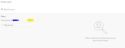

JayantaPoddar
MVP Alum
On the left pane, Uncheck the filter "Only Search in <Your Organization Name>"

JayantaPoddar
MVP Alum
> Create a group in any one account.
> Invite the user2 from the other account.
>  user2 accepts the invitation.
> Share the content to the group.

DarryStansbury
Thanks Jayanta:
We have setup a group, but when we go to "invite users" we get:
"All eligible users have already been added to this group."
It appears to be a licensing issue where we can only have 1 member?
Thanks. Darry
JayantaPoddar
MVP Alum
Think Location
FredBauhof
Yes, that did it. I had to restrict the Group members to be able to only update their items then it allowed me to uncheck the filter toggle. The screen shot helped. Thanks very much for your help.
