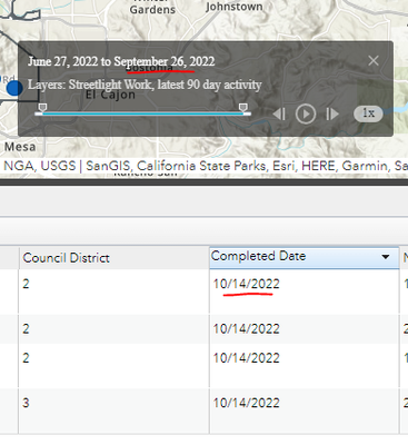

I am using the Time Slider widget in Web App Builder 10.8.1 and the start/end date/time is not updating, even though the data itself is.

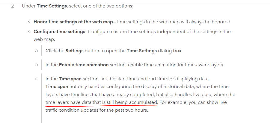

I see in the WAB documentation for the Time Slider widget that it should support this:

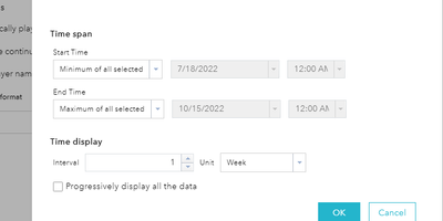

The Configure time settings menu does show me the correct dates (give or take), but this isn't translating through to the widget:
What am I doing wrong, or where can I go to fix this? Thank you

The idea of a static time slider makes no sense.  It needs to be dynamic and inclusive of newly added data.  It looks like Exb has a bug and that is why it's now showing the 10/14 data
