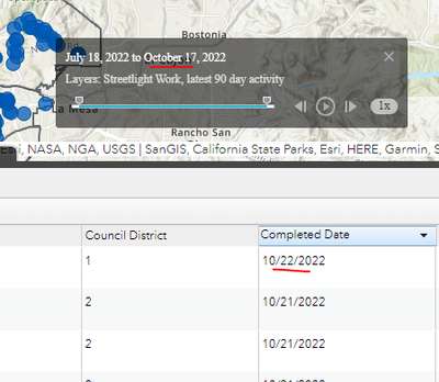

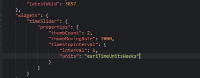

I tried this and the Time Slider widget is still not updating, WAB 10.8.1.
Deleted the ‘startTime’ and the ‘endTime’ properties of the time slider widget for my map:
So frustrating.
