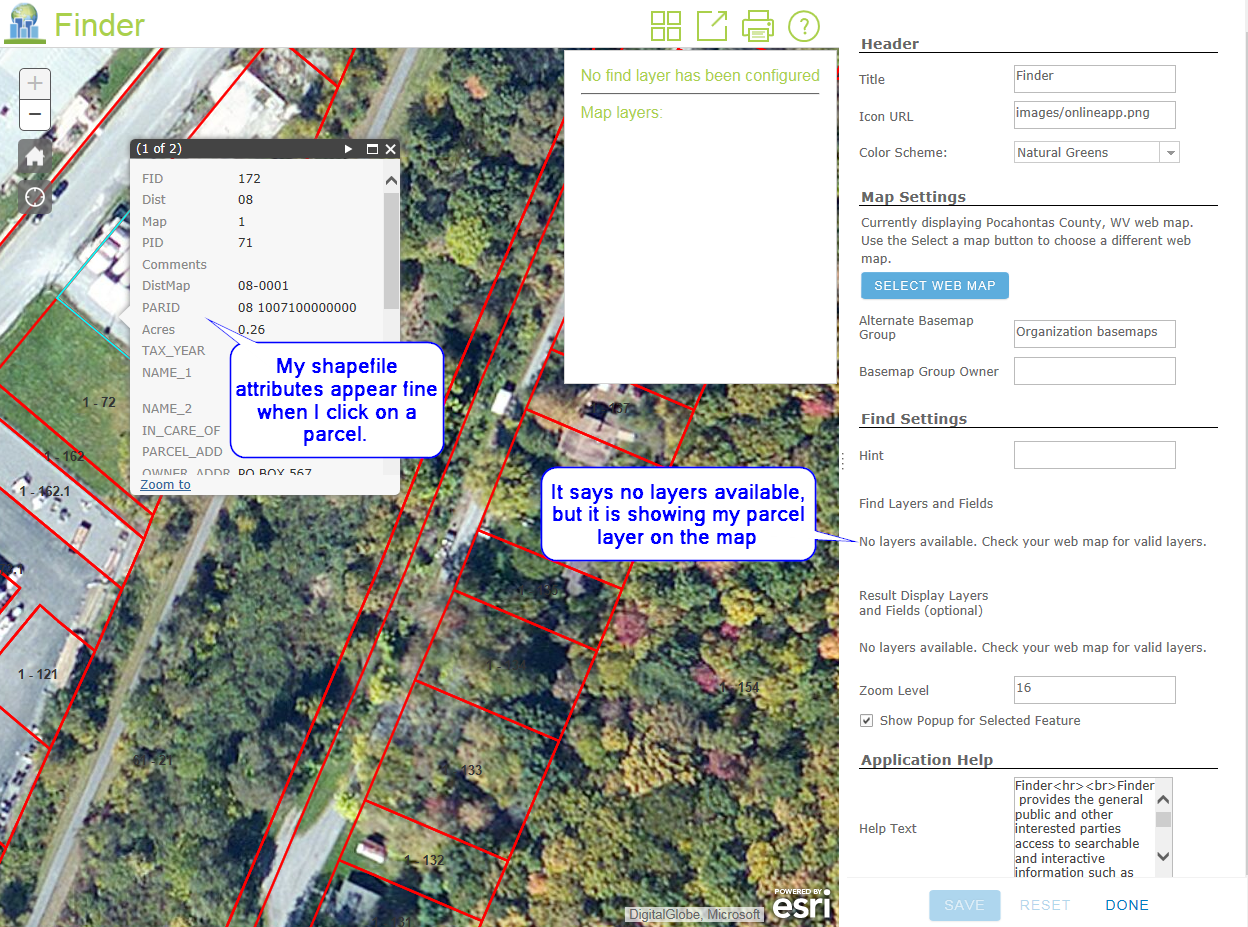

I am trying to create a web app where I can use the search function to find parcel polygons based on their attributes. My understanding is that in order to configure the search feature it has to be a hosted feature service. How do you get the feature in your "My Content" section to be hosted services?
So far I have uploaded my shapefiles in a .zip and created a map using the shapefiles. I’ve also created a web app using the “Finder” template and added my created map to it. All of my attributes are there and they appear in a popup when I click on a parcel. But when I am configuring the app it says that “No find layer has been configured” and “No layers available. Check your web map for valid layers”. How do I actually host a layer so that I can configure the search feature?

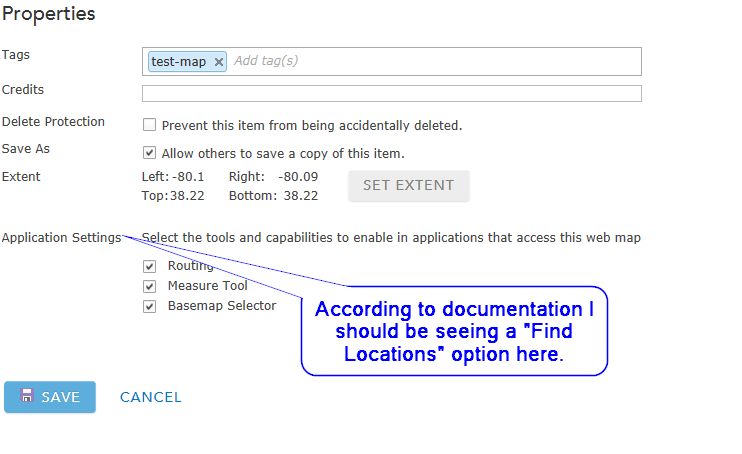

I have tried configuring the feature search based on the documentation, but I do not have the “Find Locations” setting available under the application settings.

Attached are screenshots to help explain my problem.

It sounds like the map you created is using a shapefile layer and not a hosted feature service. You will need to publish your shapefile and then you will be able to use the hosted feature service to configure a find places off of that search.

When I am uploading my shapefile as a .zip folder, I am not getting the option to check the box "Publish this file as a feature layer" that is mentioned in the docs. Any ideas to why this wouldn't be an option for me?
When I edit the properties of the file after it is uploaded, I do not see any option to publish it there either.

JamesBoggs1
Deactivated User
Russ,
I'm pretty sure that is the link I used to sign up. I tried signing up again and it said that the email was already used to sign up for a trial. Here is a screenshot of my profile as I see it. I did receive an email to activate my account. I thought I clicked the link, but am not certain. When I click it now it says "The token has expired or is invalid". Would I even be able to create maps and apps if my trial wasn't activated? Thanks for all the help, James

this is a public/free account and not a trial account. You should be seeing your account profile under your orgs URL which would look something like jameswv.maps.arcgis.com . Right now you are just under arcgis.com and that is a view that public accounts would see. Also the role information would be displayed in the same colum as region, units.  You would also see organization and organization URL on this page.
Can you try and spin up a free trial under the URL i posted in a comment above.
