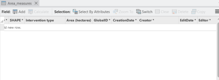

This script works fine for 3 feature layers that I have online, but not for another 4. It seems that the problem lies with the data.export part of the script, which for these 4 layers exports an empty file geodatabase. I've attached a screenshot of one of the attribute table of one of these layers to show the issue - the data schema is exported but none of the data actually within the layer.
Basically, I am just wondering what could prevent the data from being exported - I have checked the settings on the layers and can't see anything different from the ones that successfully exported.

Apologies, I actually was doing the manual download under a different account - however the account I use to run the script has admin access, could it be something to do with ownership of the data?
Nick_Creedon
Yes, ownership does take into effect. The layers must have export enabled in their setting, if you are not the owner and not a admin. As Administrator your role overrules the need to have export enabled.
